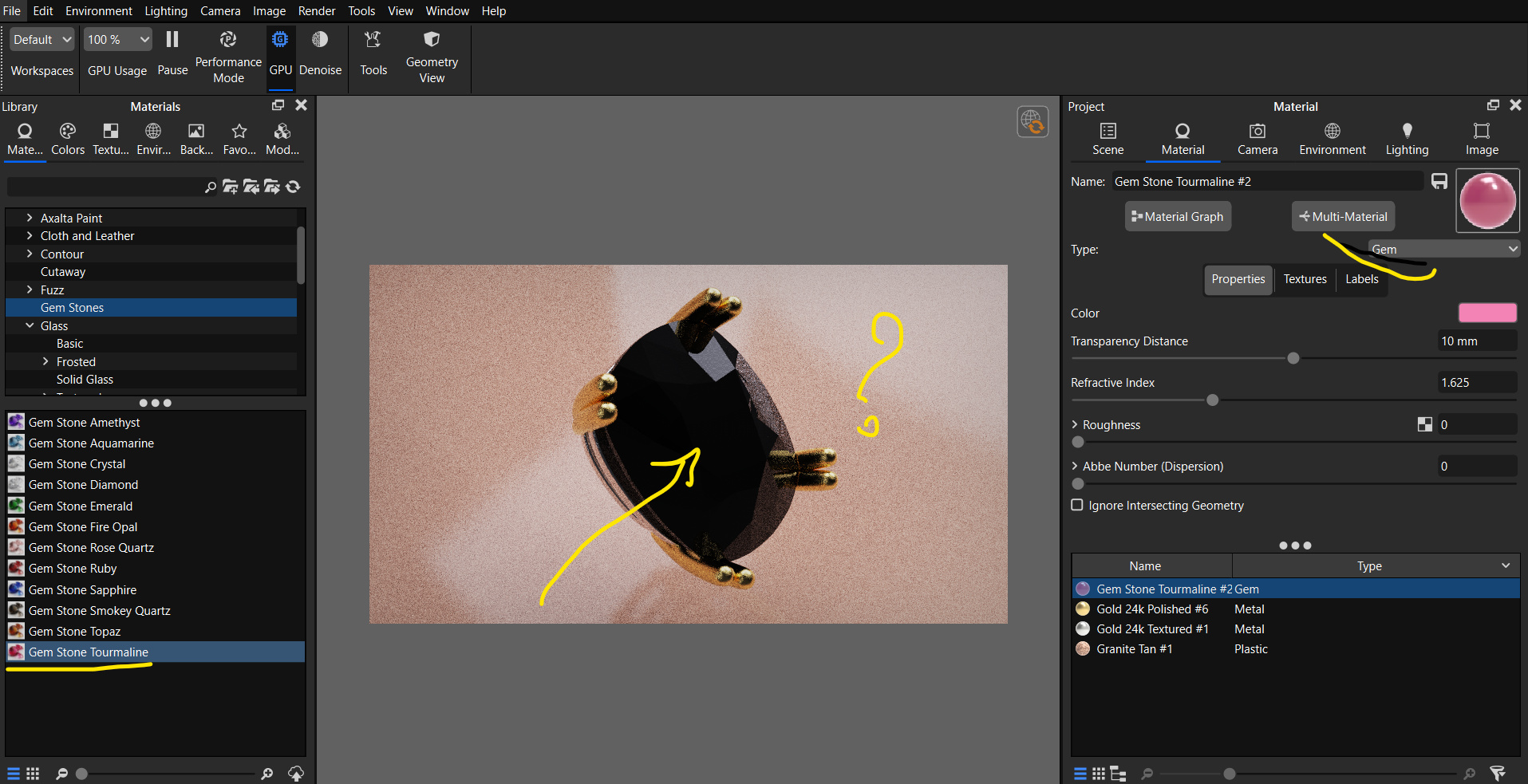

Hello community.
I have a problem with the display of colored gems.
I use entry level of video card 1650ti with 4 GB and updated drivers
Hi, my guess is this has to do with the scale. Your diamond is likely very large. The transparency distance is how far light must travel before it reaches the specified color. At 10mm thick, your gem should look like that pink color. But it’s way darker. If you take that 10mm and make it 100mm, does the color get lighter? If so, then what I’m suggesting is likely correct. Try scaling your gem down so it is the correct scale. Does that help?
Will, Thanks for your advice.
It was scale -transparency distance.):blush:
